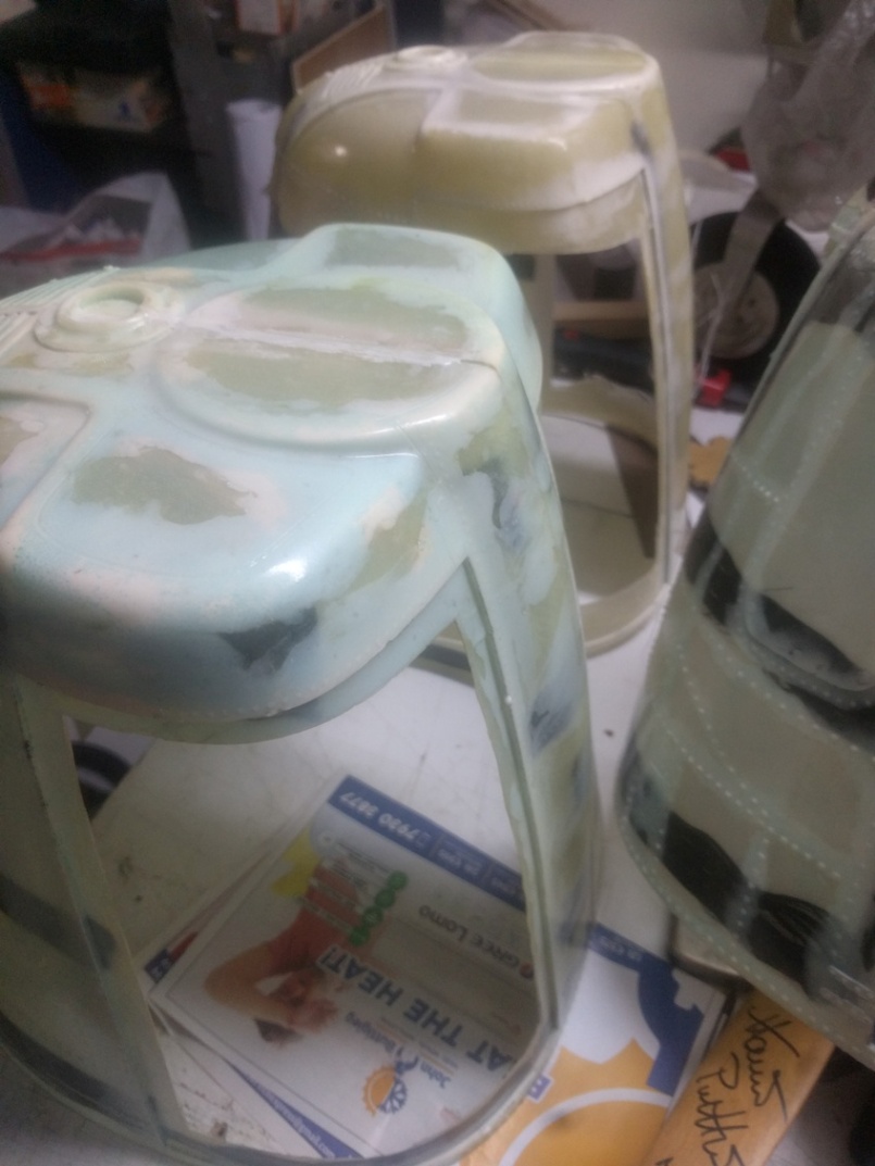

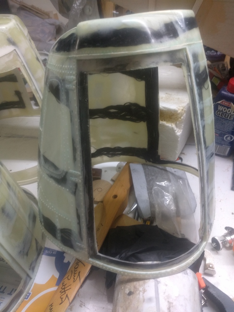

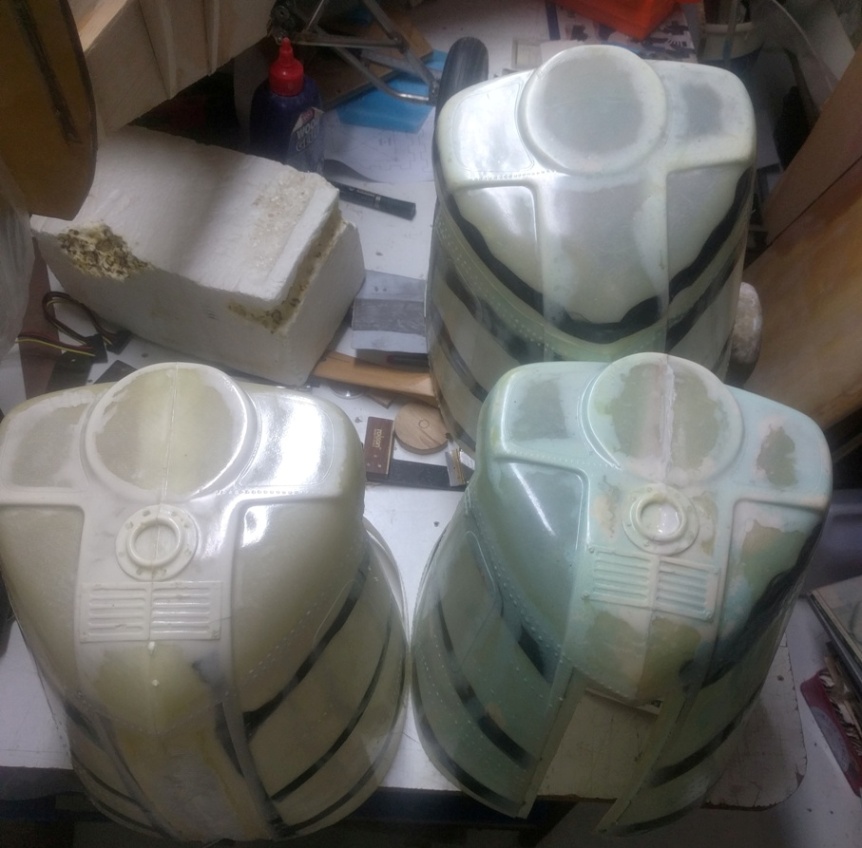

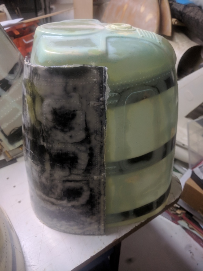

As Sparky highlighted the cowl of the Bonanza and the T-34 are practically identical. The cowl tapers off to the front so the best type of engine would be a 4-cylinder engine. I believe Mike Barbee's engine on his T-34 plane has, I believe, a 222cc four cylinder engine. Most four cylinder type of engines drop fit inside the cowl. However, there is always the dreaded cooling and baffling problem. I believe it is a must on such planes.
Here are a few shots of the cowl I made. My intention is to have open cowl hoods and that is why you see the large openings on the cowls. Meanwhile I am also enclosing a photo of hood placed against the. The hood still needs trimming and fitting out. I could make it separate or a one-piece thing

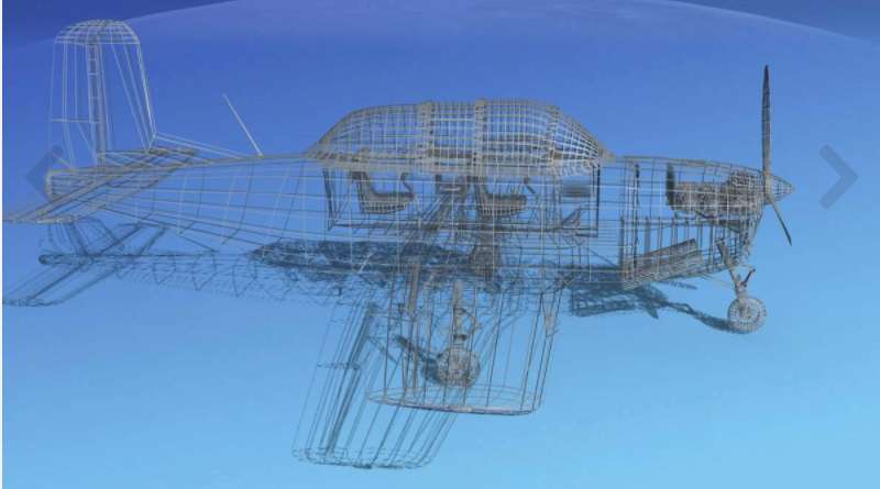

Before you go looking for the 1/4 scale "kit" you should be made aware of Mark's design is a fiberglass fuselage, cowl, with a foam wing, and vacuum formed corrugated Styrene. This is not a built up wood kit with fiberglass cowl. Retracts for Mark's design came from Robart. The canopy is still available from Ziroli. The cowl in its T-34 form appears to no longer be available, however Reuben's (Sabre) glass cowl would work well.
Fortunately there are multiple CAD T-34's to provide all anyone would need to do a built-up T-34.
