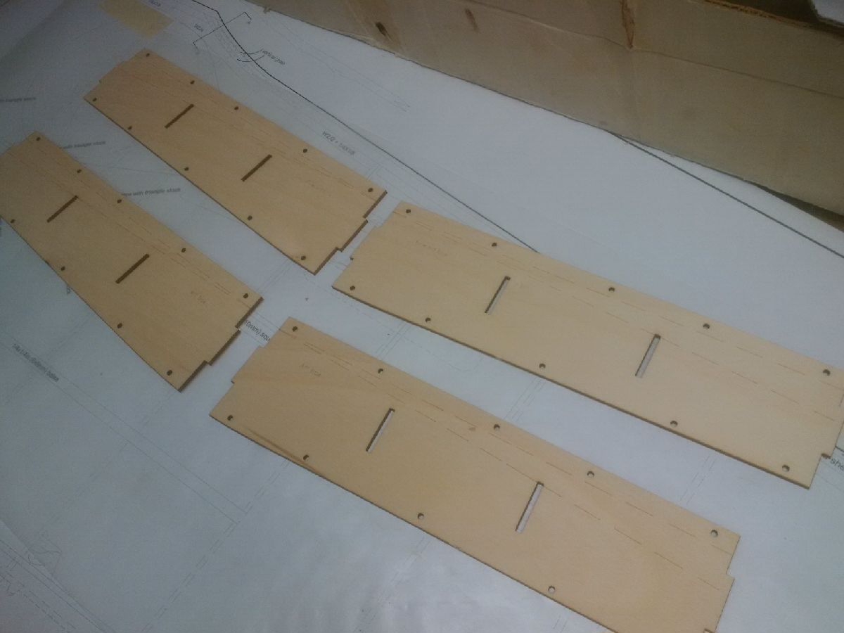

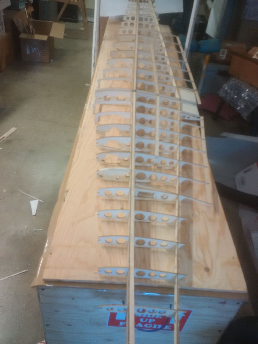

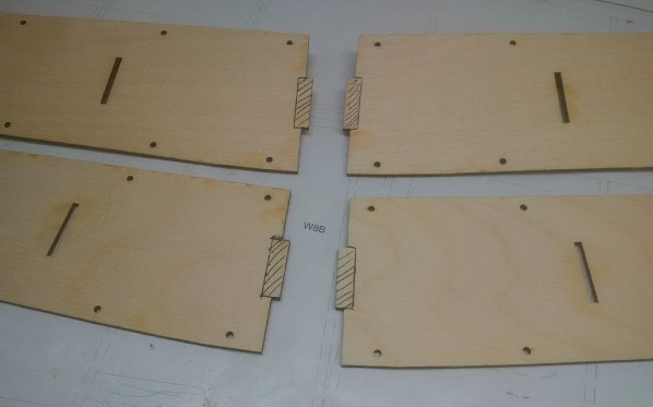

Building the spars balsa and spruce:
and wing joiner boxes had to be revised for a notch instead of a tongue where W1 meets the W1 rib.
JG

Posted: October/11/2018 at 1:32pm  Quote

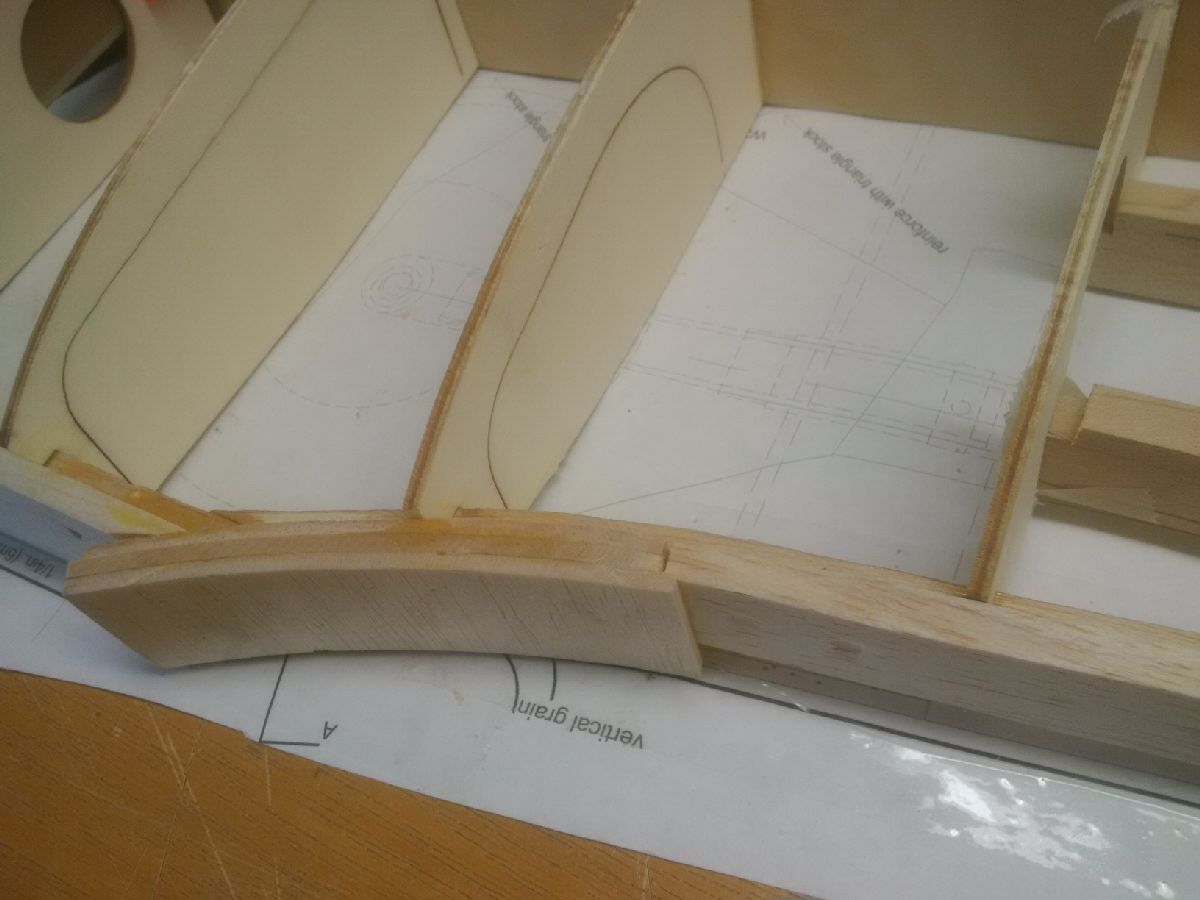

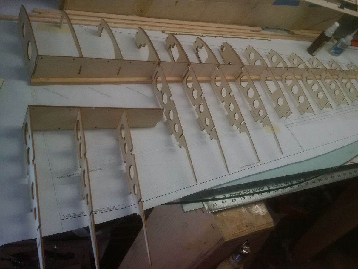

The laser parts fit very well with only a few adjustments to the depth of the slots, which I revised in the CAD files for the next batch:
The wing joiner box walls get the ribs attached first, but I suppose these ribs can wait to be glued later.

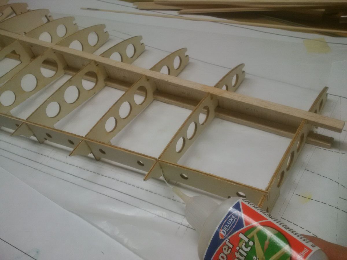

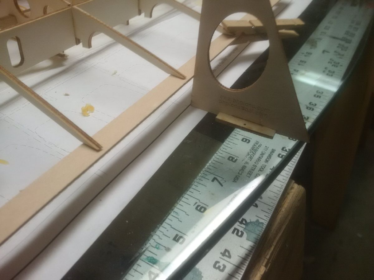

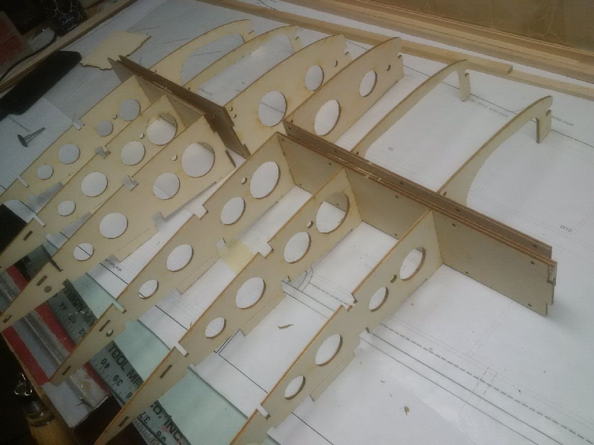

Ribs 4, 5, 6 and 7 have hard ply doublers, so I glue those to the ribs before anything goes together.
With the bottom spar on the plan I place all the ribs where they belong using the sheerweb to keep separation and right angles.
Some of the sheerweb parts need a bit of trimming, but it all goes together nicely:
JG

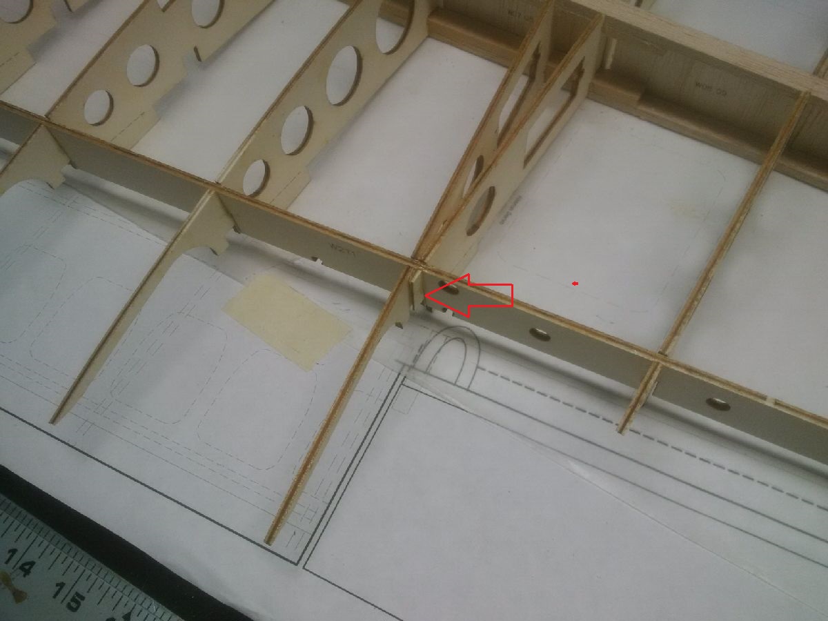

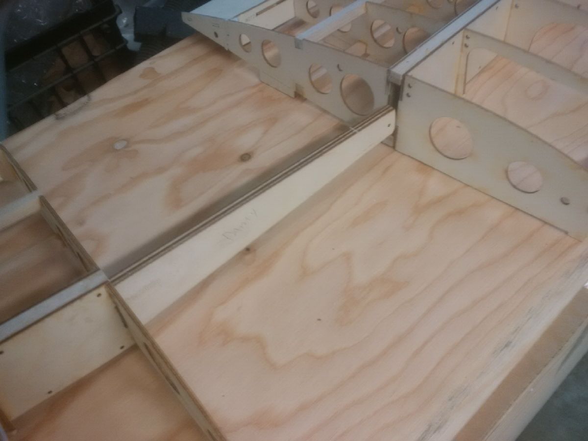

I found Rib 8 tail end is a bit too long and interferes with 8B so needs to be sanded or cut :
Trailing edge is 1/16 spruce sheet and needs to match the plans
Next I need to go over all joins with slow Superphatic :
JG

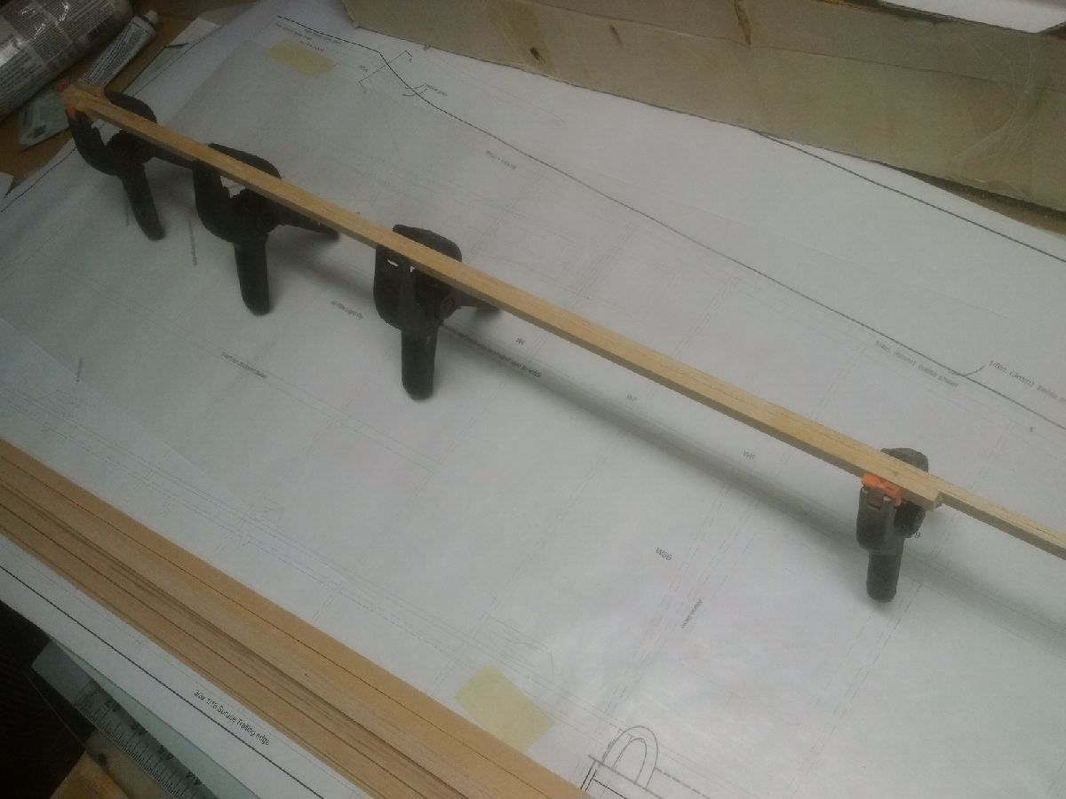

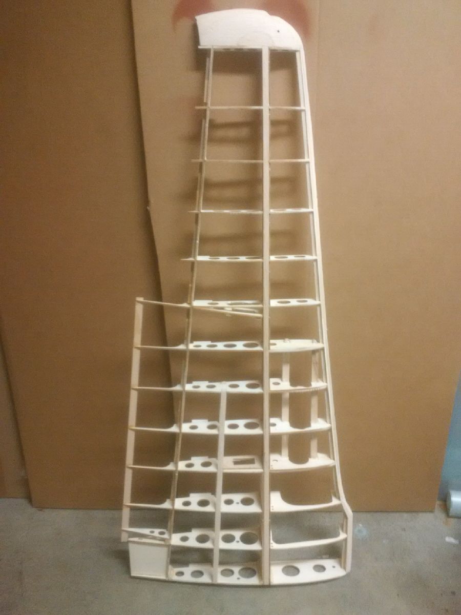

Posted: October/15/2018 at 7:39pm  Quote
Left wing mostly framed, can't resist to see how it joins the right side:

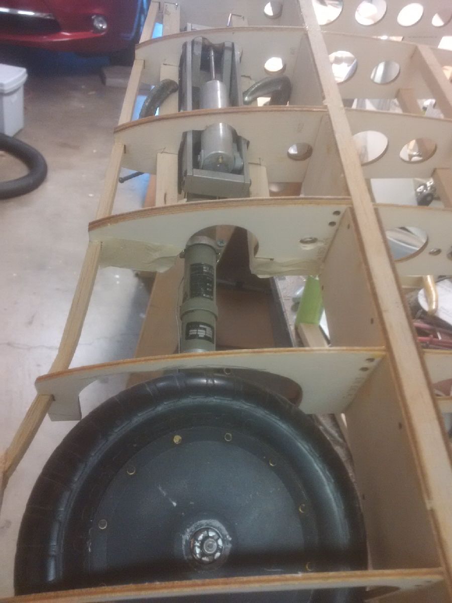

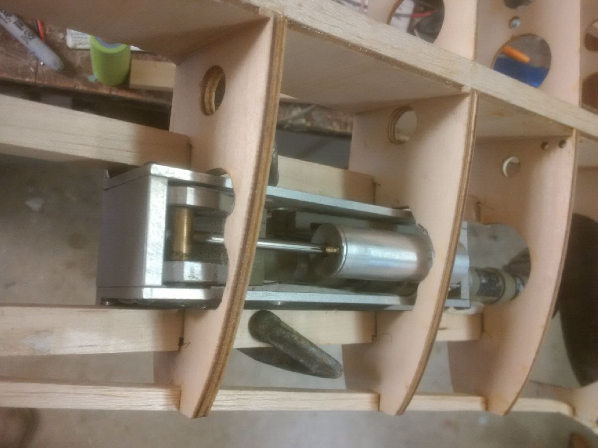

Posted: November/03/2018 at 6:46pm  Quote

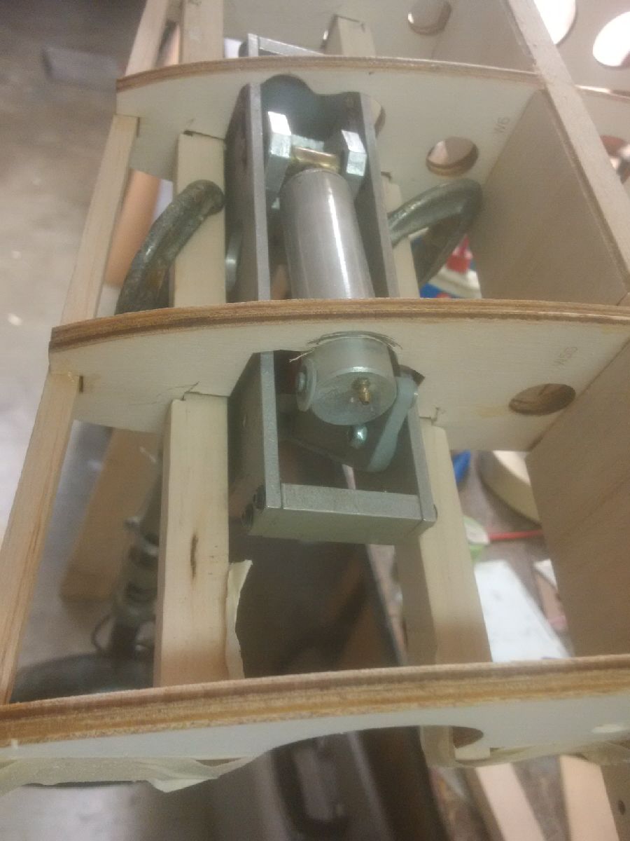

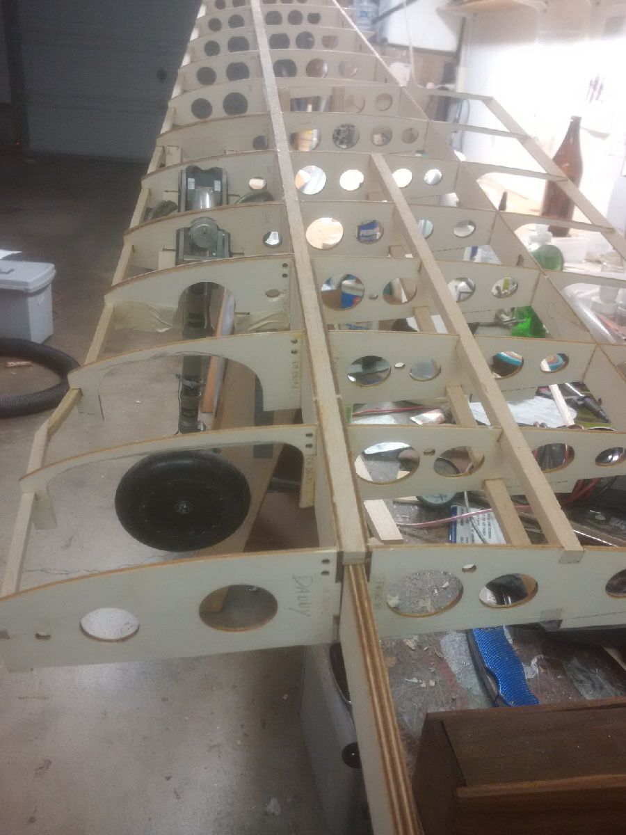

As wing build  progresses, I need to check landing gear fit before epoxing the landing gear bearers and some ribs need to be trimmed for the cylinder movement during gear down swing.:

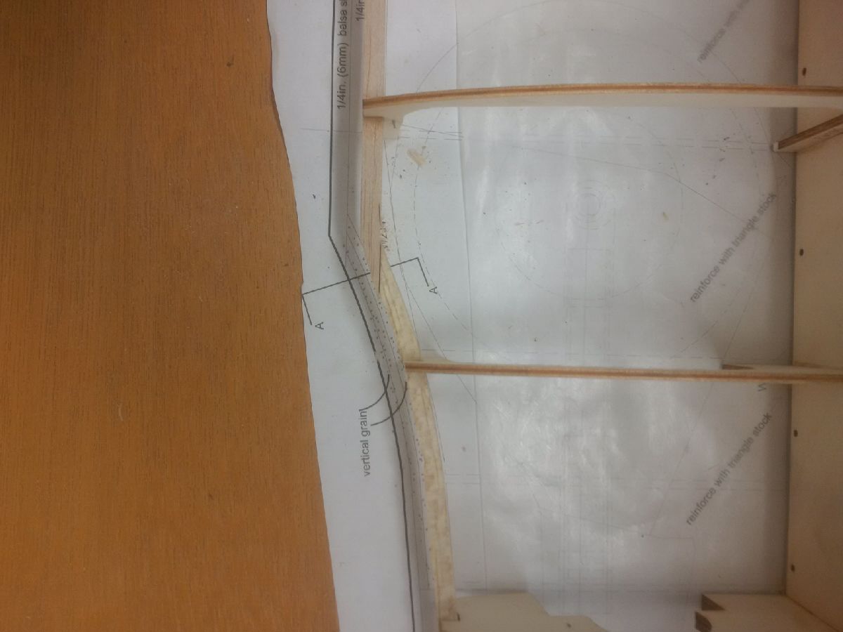

Next before sheeting the wing is complete the L.E.:
